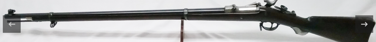

Tom and Dick there is LRR 162038 with the sharp sights and kelton trigger for $12,500 but part of It has been chromed. Auction Guns international https://www.gunsinternational.com/guns- ... =102274090
To bad it got chromed. Is this one a new find? Best Frank D

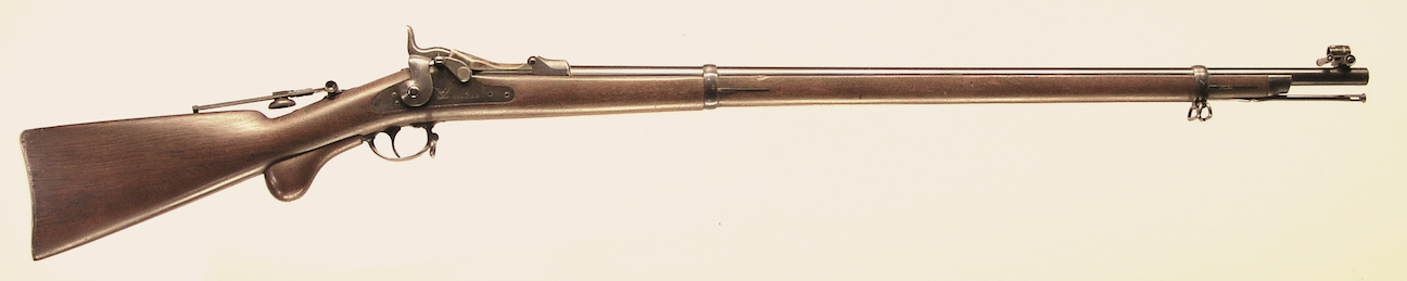

Well, that must be the "Baltimore gun" that John saw - certainly it has been "badly refinished", and yes, that is an unknown number - though within the accepted range. It has the Hotchkiss butt, which cannot be faked, and I see no sight holes in the barrel. All that said - "Houston, we have a problem" . . .
Those are NOT(!) the Sharps sights seen on the other specimens - so - there IS a "story" there, but I do not know what it is. I do not even know if those ARE "Sharps sights". Someone with more experience in that area than I, will have to 'splain' that part to us. Also, note the crude (would never have been done by SA) notch hacked into the comb to allow the leaf (which is not even as long as the correct one!) to seat. Note picture of 162036, which shows the abnormally short comb on the genuine guns. This one (162038) has been fooled with, and I personally would not pay the price asked. I'll put it in the book - because it is/was a Long-Range, but with several asterisks.
AFAIK, that is the only dicked-over rifle in the sequence (which IS twice as large as the quantity of sights recorded as purchased from Sharps).

Seller's description for 162038 includes:
"This rifle still has the original metal pistol grip with the original owners information engraved on the bottom ...Please Note: This is a one owner firearm. There is also a letter of provenance included"
Someone should contact the seller and ask about those details.

Aha - then there may now be ten! I have queried the seller - we shall see what, if anything comes of it. Sure wish you had the Baltimore number - do you know the seller and can you contact them?
Upon checking the pics further, I see that 162038 was previously mortised for a longer (probably the original) tang sight base. The front sight appears similar to that of a Marksman's rifle. The plot thickens . . . perhaps the rifle was, at one time, just like the others, and was modified to suit a previous owner's desires.
UPDATE: Received a 'phone call from the present owner. Best response I have EVER had. Rifle is in Oregon. Came out of Bannerman's many years ago, with features as shown, one owner since until brought into store. That pretty well confirms/explains things. Pistol grip is actually marked Bannerman! I definitely feel better about it now - just too bad it was molested - was almost certainly correct to begin with.
