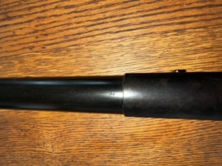

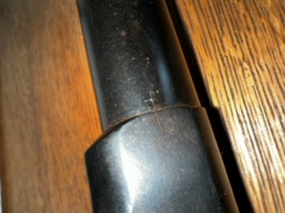

My carbine and rifle both have large eagles. BUT both do not have any initial behind rear sight on barrel top? most will have an R or A.
Re: 1880 rifle recall
My carbine appears to have the large eagle although there is no second P.
There's no letter stamped on top of barrel in front of receiver.
Here’s pics from mine no P on underside, no inspector initial on top of barrel, 175xxx with the flower looking star …..
