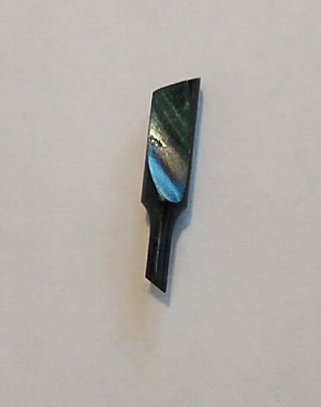

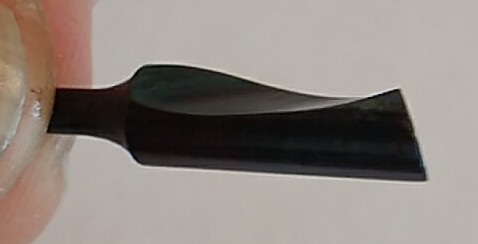

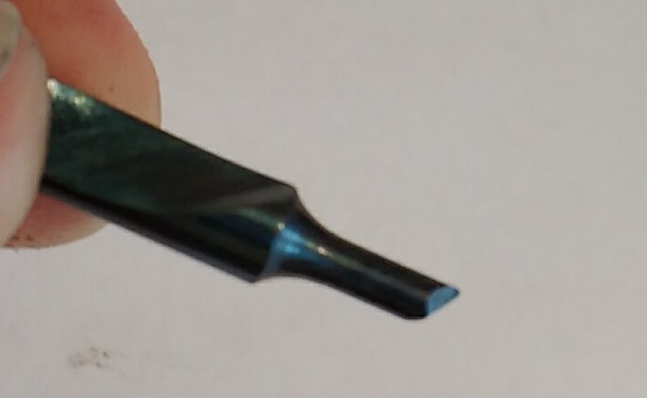

As per Tom's suggestion, here are some photos or a new made Parker Snow Miller Conversion firing pin. In my opinion the gun smith did an excellent job!!
I'd like to find an original to have for my rifle should anyone have one of these laying around in small parts accumulated over the years.
Thanks in advance!
At the thickest point it's 1/4" and around 1 3/16" long.

That's just down-right weird looking! Never seen ANYTHING like that before, and if I had one, would NEVER suspect it to be a firing pin with the sharp edges/points. First thing that comes to my mind, if I found one on the floor, would be that it was some sort of cutting tool.

Dick Hosmer wrote: Sun Nov 05, 2023 3:13 pm That's just down-right weird looking! Never seen ANYTHING like that before, and if I had one, would NEVER suspect it to be a firing pin with the sharp edges/points. First thing that comes to my mind, if I found one on the floor, would would be some sort of cutting tool.
Yes it is Dick! The angled beveled cut on the side is where the pin goes in between the breech block and lifting latch. Not sure how that cut was made, even back then.

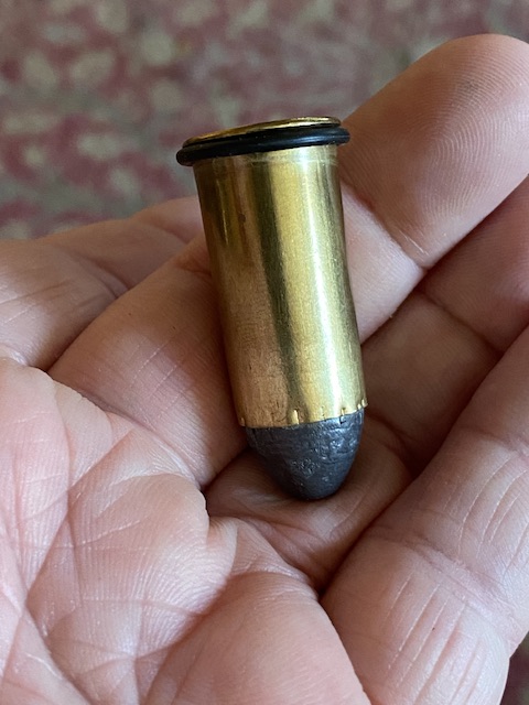

I found an O-ring that catches the extractor and seals gas on my .58 Centerfire Remington Rolling Block.
Re: Original miller conversion firing pin needed
Nice Fred! O rings were a tad too fat as they stuck out the sides too far. The rubber bands for braces shrink down in thickness as they stretch out and end up being just a tad over the rim.
