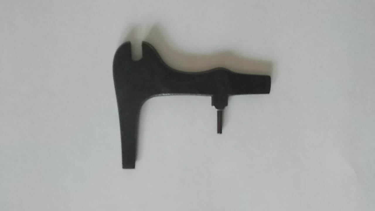

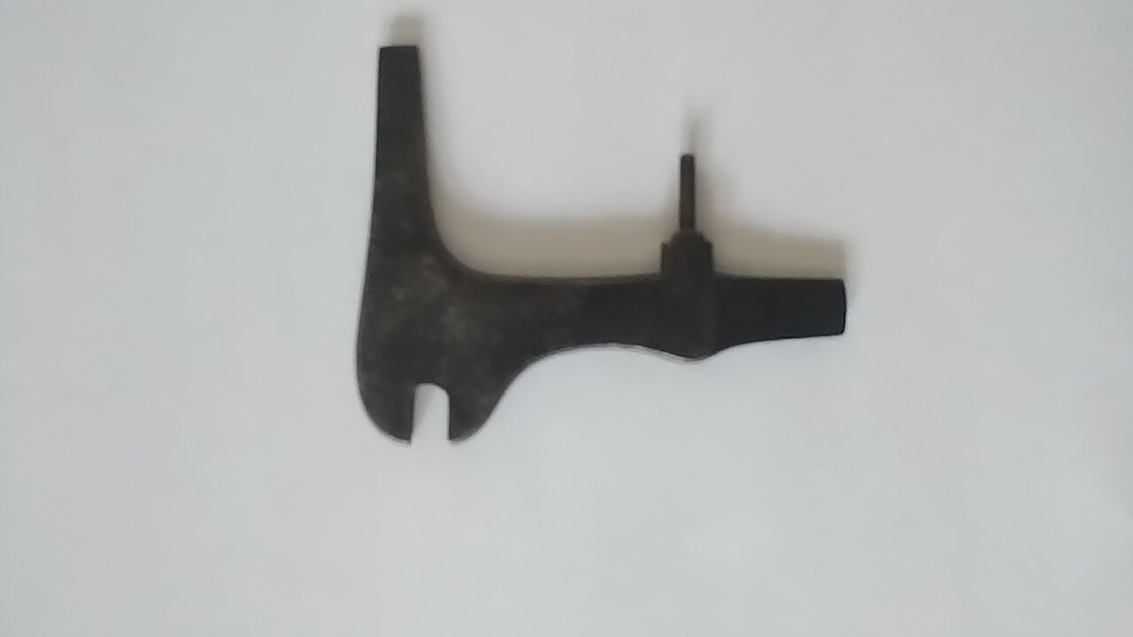

True Dick as I have a 4th type or variation I guess you could say.
Here is a tool to go along with the 1870's trial period. Don't know the exact amount of these tools produced but they are rather scarce.
Re: Model 1870 with number 29 on bbl and receiver?
Yes, and I think they come in two slightly different sizes, one basically same as the 1879, and the other larger - which I believe is the scarcer of the two, but you are correct, neither is common. Isn't the larger one supposed to be associated with the Ward-Burton?
I believe the smaller one was for the Ward Burton.Dick Hosmer wrote: ↑Wed Aug 30, 2023 8:27 pm Yes, and I think they come in two slightly different sizes, one basically same as the 1879, and the other larger - which I believe is the scarcer of the two, but you are correct, neither is common. Isn't the larger one supposed to be associated with the Ward-Burton?
Correction, the larger tool is associated with the Ward Burton. Here is a page from the news letters.
