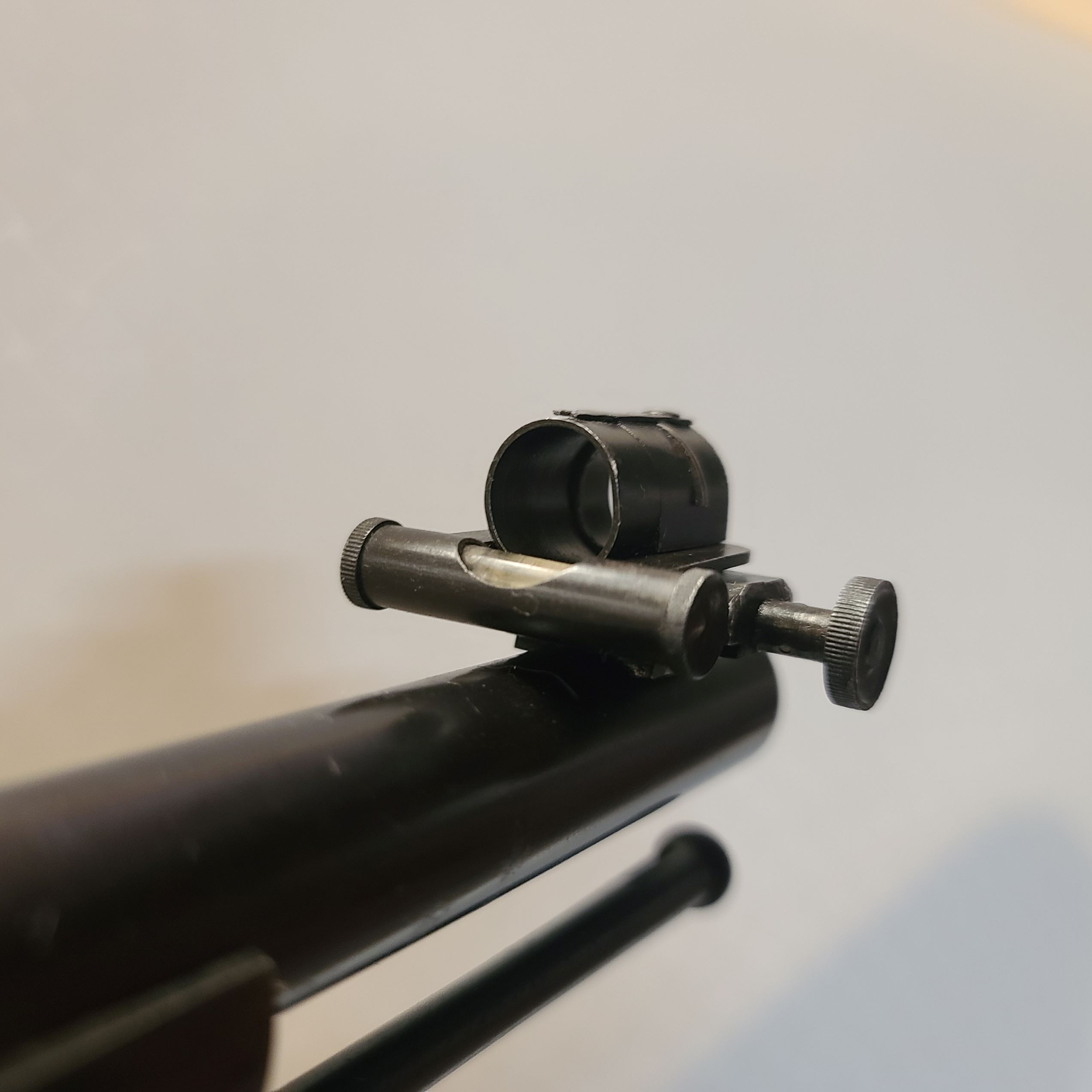

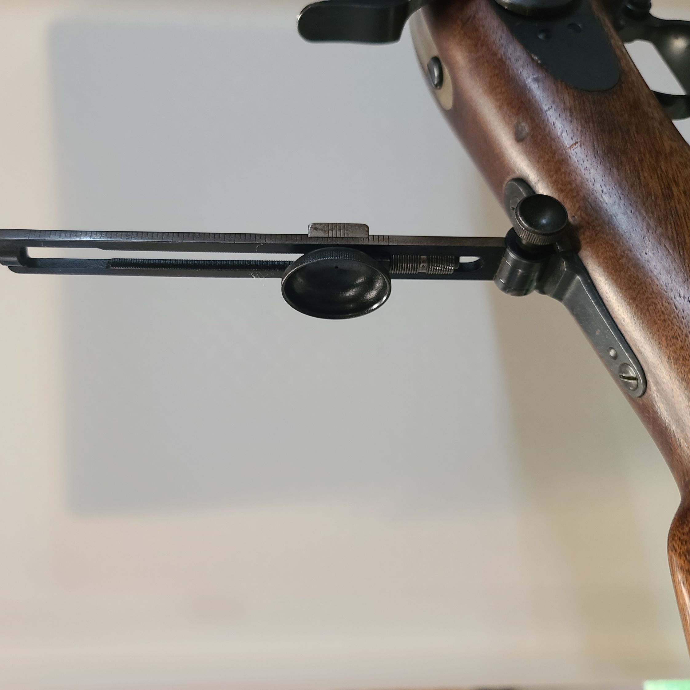

These are on the known LRR #162045 shown on pg 94 of Al's book.
sharp front resize.jpg (246.15 KiB) Viewed 7726 times
sharp rear resize.jpg (243.81 KiB) Viewed 7726 times
Re: Long Range rifle sight question
Those are exactly the same as the sights on 162036. I assume the barrel is NOT drilled & tapped at all?
