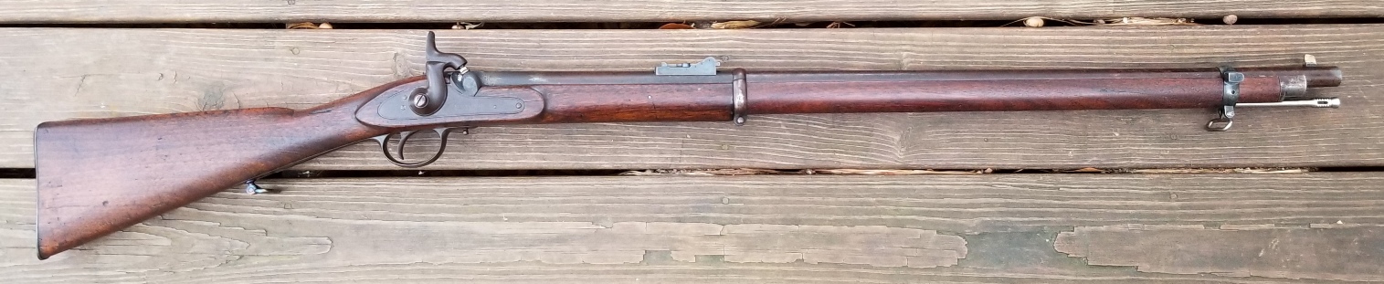

The best match I have found is Behlen Hickory stain. Unfortunately Behlen was bought out a couple years ago. I don't know who the successor is, but an internet search should pull them up.
The original armory stain was based on Dragon's Blood, which is made from Sumac berries. The formula is in one of the Chief of Ordnance reports from before the Civil War, but I don't recall which year. It's also reproduced in one of Claude Fuller's books. (Probably easier to find there. I'd start with Springfield Muzzle Loading Shoulder Arms)
Here is a stock that was cut off and I spliced under the band then stained with Behlen Hickory.

Really nice match, Tony!
