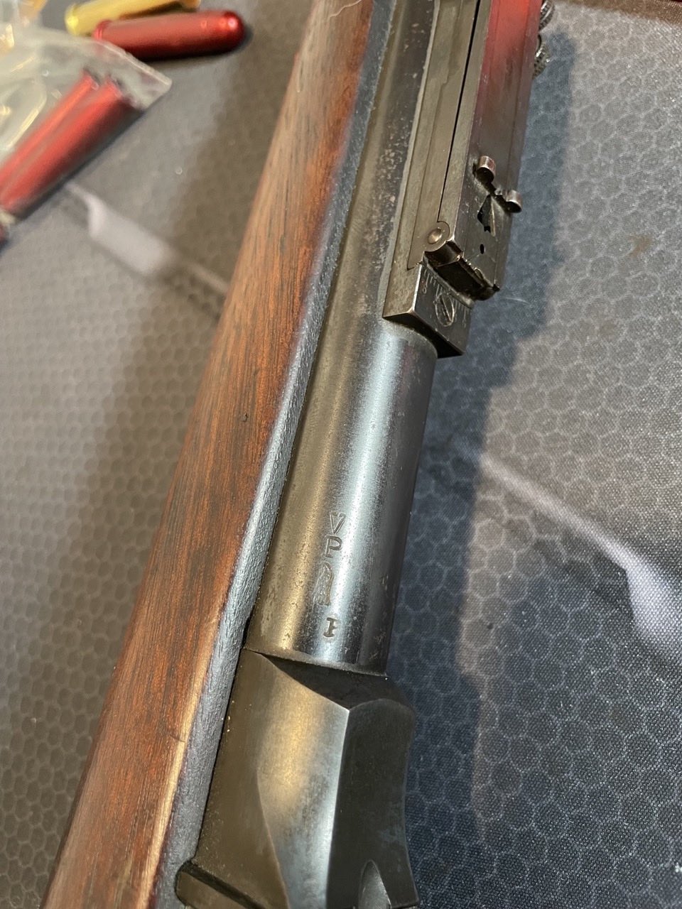

Here's a picture of my rifle (hopefully showing the markings clearly)
P marking outline-1.jpeg (236.83 KiB) Viewed 5560 times
I am seeing a few issues:
1) The second P is not directly below the eagle, but offset to the right, and also appears to be in a different font than described in the book.
2) It appears not to be complete? The right side of the letter P is missing.
3) I could see a faint outline around the P which appears to be a different color from the rest of the barrel.
Could this mean this second P mark was not original? Since this is the actual pressure proof mark of the rifle, I want to double check before I take this rifle out and shoot it. Has anyone seen markings like this? Many thanks!

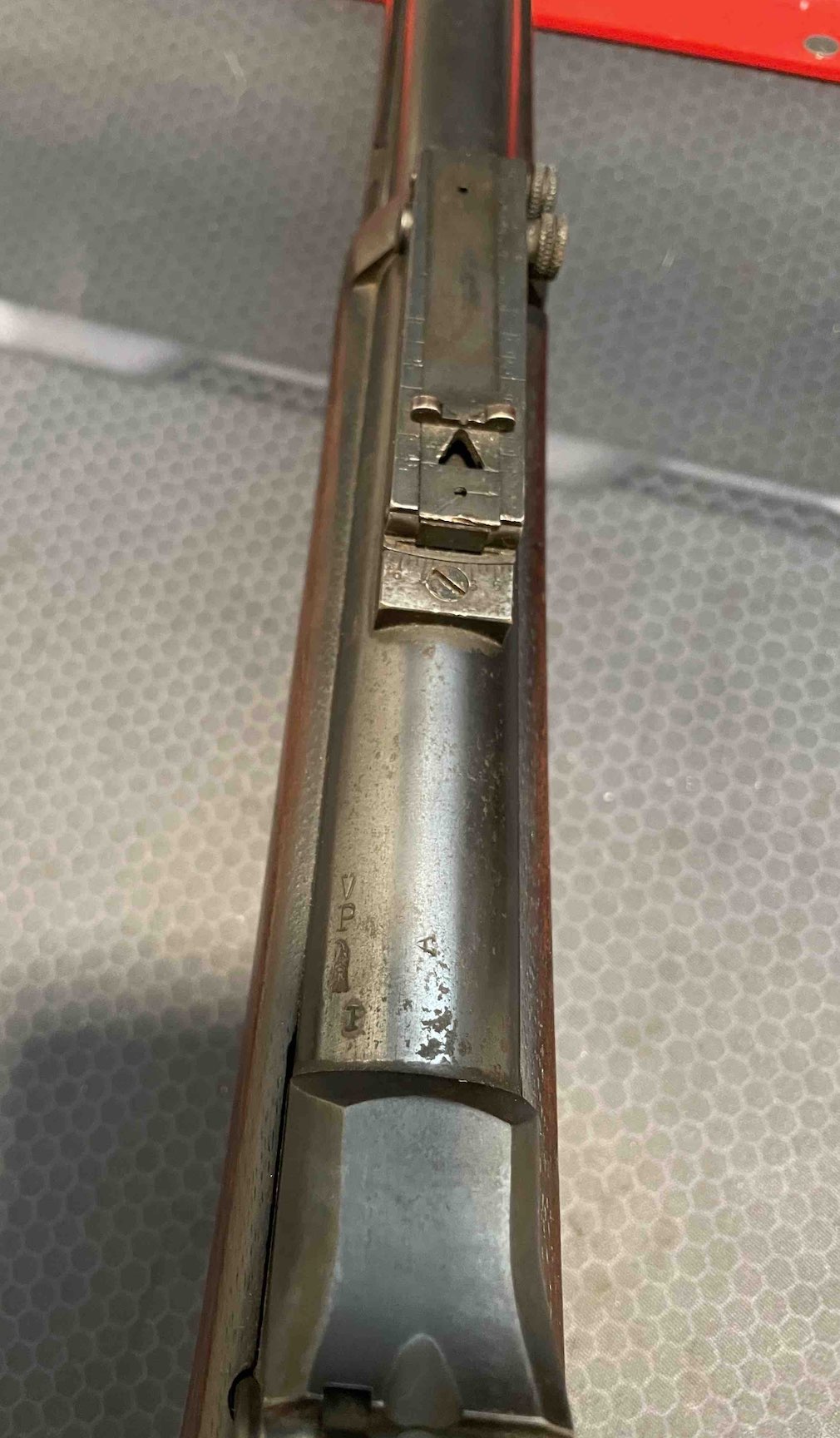

One more picture:
Re: Barrel proof mark doubt
The second P looks correct to me although it’s a tad out of line. Most of mine are in line but there are some slightly off. Could be the guy making the mark was having an “OFF” day 😁
The way he was holding the punch prevented the complete P to mark the barrel.
Just my 2 penny’s.

carlsr wrote: Mon Apr 29, 2024 5:27 pm The second P looks correct to me although it’s a tad out of line. Most of mine are in line but there are some slightly off. Could be the guy making the mark was having an “OFF” day 😁
Just my 2 penny’s.
Yes I was thinking about that too. Maybe the punch wasn't held correctly.

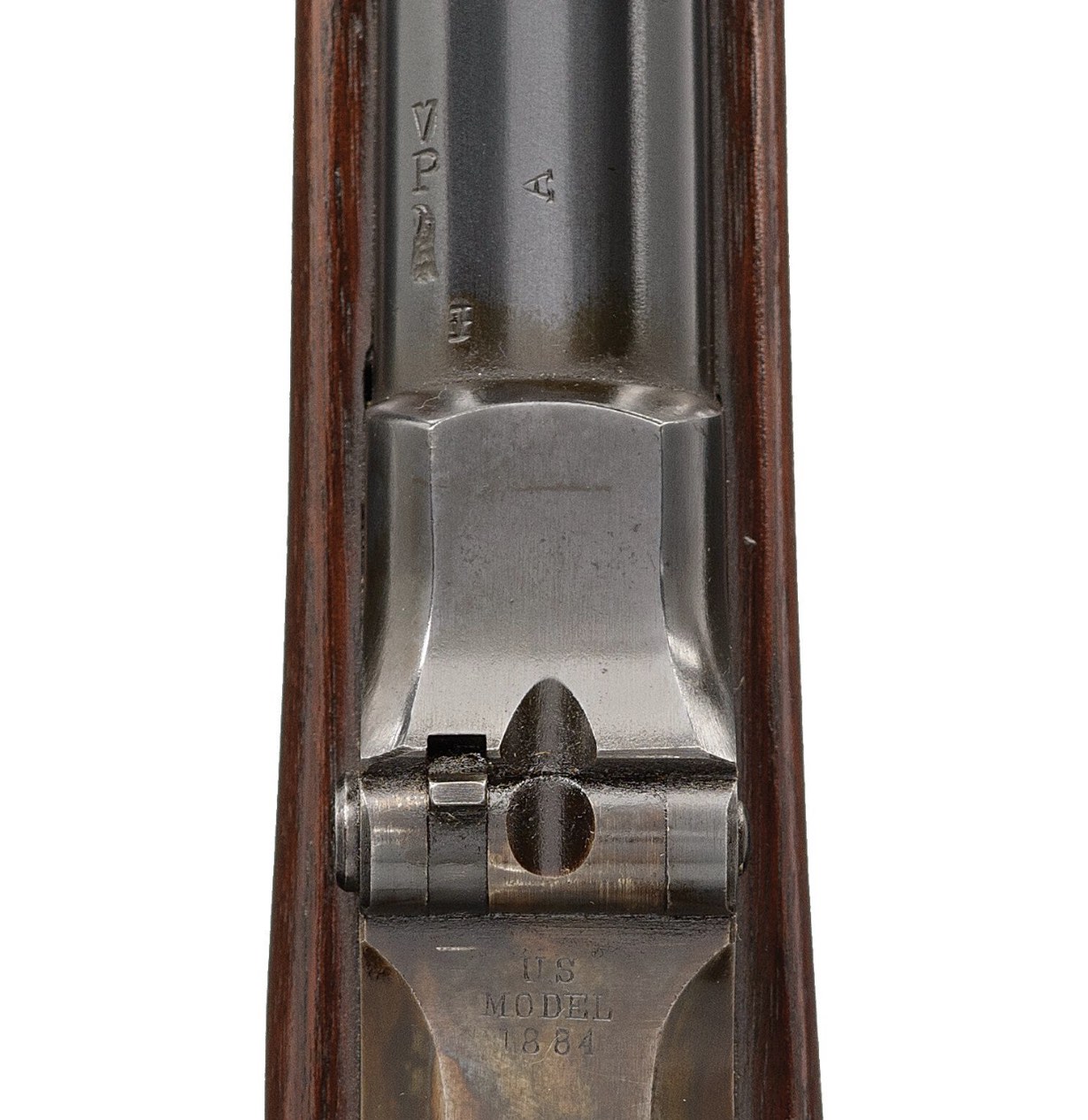

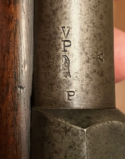

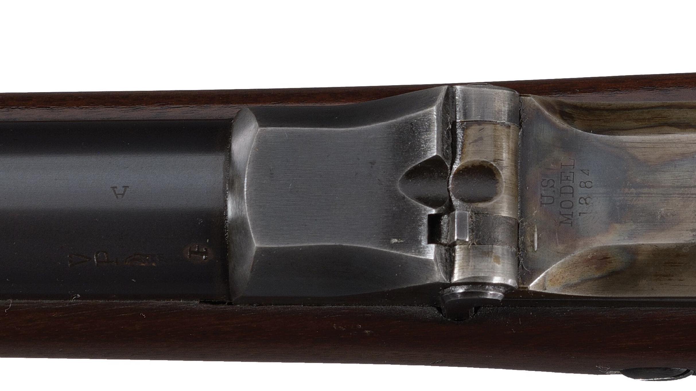

Then I found these listings, with the exact same "issue" as mine.
https://www.rockislandauction.com/detai ... door-rifle
These are really nice rifles. Serial numbers are pretty close too, indicating early to mid 1889 production according to records. My serial is 419xxx, so late 1888.
Hah, perhaps around that time, some guy at the armory just had this unique style of punching? :D
This does give me some peace of mind. Odds of some random guy stamping fake marks sound a little low now, since we have 3 rifles looking exactly the same.

I've seen them much worse than that - wouldn't worry at all.

My early 1889 built Model 1884 also has its second P slightly out of a line so maybe that was just something that was happening during that timeframe with the inspector who was making the stamp.
