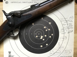

Here’s a pic of my ‘73 cadet and an old target:
Not too shabby, me thinks (for 82-yr.-old eyeballs!
Re: Cadet rifle
Not too shabby for sure!
