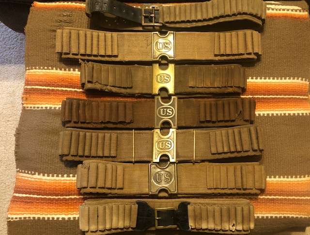

Top - Model 1876 Prairie Belt
Bottom - M1885 Cartridge Belt
In between are samples of the 1880 Mills belts with variations of the belt plates and keepers issued with them in chronological order.
throck3

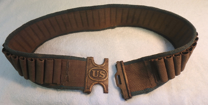

Hello
Here is a link to What Price Glory on e-bay showing their Mills belt with the blue selvedge and then a photo of the real thing
Check WPG's other auctions for other belts and accoutrements
