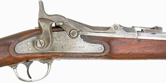

Here is the text from one Al had listed and after discussion with him I bought. This is from about 5 years ago. I saved the pictures as a pdf and I have no tool to change it so I can post the pictures here. I am recovering from the covid so may be slow to do follow ups.
"Model 1870 Cadet Rifle
It has been discussed for many years as to the existence of the M70 Cadet Rifle. In my many years of researching, this is the third one that I have found that seems to fit the bill. M69 cadet rifles were produced using new stocks, and they are missing the spoon and the cut in the stock for the spoon. Also, the M69 cadet rifle has the ski slope cut on the left rear of the receiver. They also have the M69 cadet rod and M70 rear sight. This rifle has all of the above features and is not cartouched. At first, that was disturbing, but in 1876, twenty M70 Cadet rifles were produced. Why twenty?? and why 1876?? They are two very good questions. There seems to be no paper trail on the guns, nor any details of their production. This M70 cadet has the circle P firing proof which it was finished in 1873 or later. Also, the flat is missing the ESA cartouche. It has all the M70 features, except it has an M69 rod rather than an M70 rod. I believe it to be one of the twenty produced in 1876. It is not uncommon to find early guns refurbished in the mid to late 1870's without new cartouches, so that is nothing new. The bore in the rifle has very deep rifling for a 50-70 and there is a little crude in one rifling groove. The lands are minty ."
I did do this screen shot.
