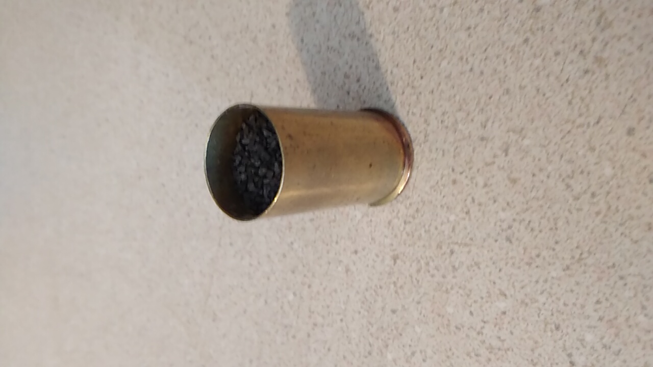

Just out of curiosity I filed a case with 60 grains of 2f swiss black powder. The powder just about fills the case and since there are no dies available to compress the powder or seat the soft lead bullets I have no idea how they used a full charge??
I compress the bullet slightly in my press using a 28 gauge shell holder that I milled out a slot so that the primer is not on the shell holder while compressing the bullet against the bottom of the turret.
I've contacted a couple specialty die manufacturers to possibly have a die made to just seat the bullet with a slight crimp but have had no luck.
I have altered an old flaring die to slightly crimp the bullet for now.
This is a case filed with 60 grains.
