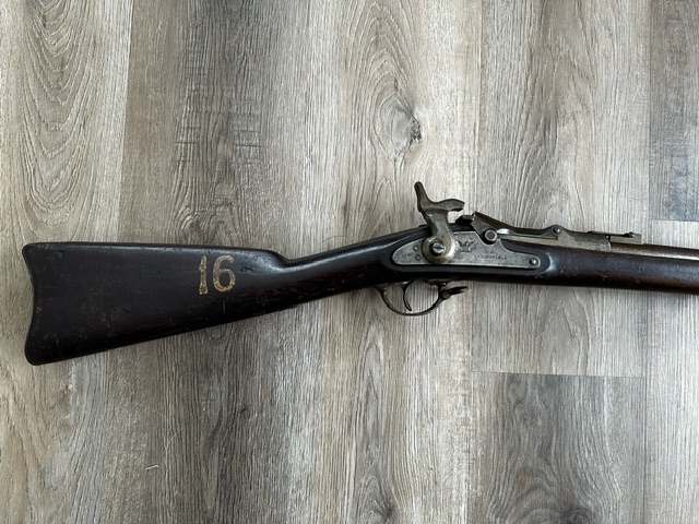

Here’s a rifle I picked up recently. It has a nice bore and I plan on shooting it as soon as I secure some .50/70 brass, I have all the other components. 42681 is the serial, block is dated 1870. It came out of NJ.

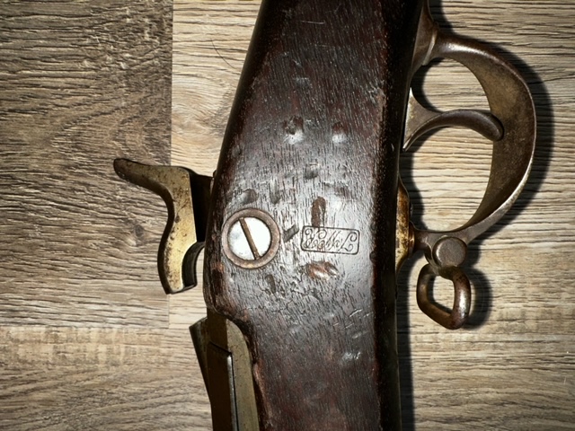

Where is your rifle marked NJ?
Re: My marked 1868 trapdoor
My disclaimer, I’m not encouraging anyone to load how I load and an expert should verify any gun and load for safety before shooting. This is not data to be used by others. I started off using info from an internet article in the black powder cartridge news but I found I couldn’t use the full 60 grains of powder as he did. I used an unsized lee 515-450-f bullet about 30-1 hardness I figure, lubed with half bees wax half lard pan lube, and 53 grains of 2f goex made In 1972. The casings are starline .50-70. I tried 60 grains but there was just too much powder compression and it distorted the nose of the projectile. I love the balance of the gun, the sights not so much lol. I don’t think the gun is marked NJ, the last owner found it in NJ though.

My mistake, when you said the rifle came out of NJ I thought it was marked NJ 😂😂

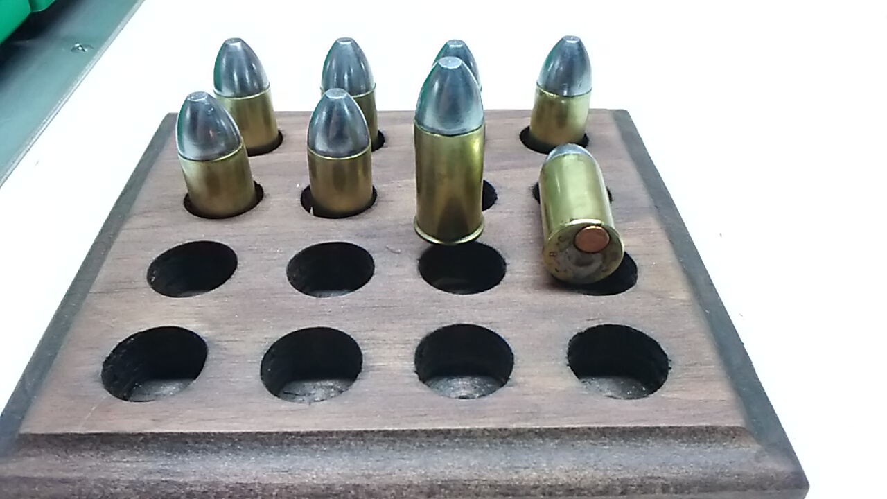

Loaded up some .58 rim fire a couple weeks ago for my next trip to the range.
I use these for my 1865 1st Allin and my Parker Snow Miller Conversion. Took a while to make the cases, made around 40 so I'm good for a while.
