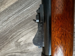

Why is the ‘79 carbine sight marked for 100 yards but shoots 12” high on average at that range using the standard carbine load? I’ve heard the 250 yard battle sight theory but why did the mark the sight for 100 yards then?

I get that, it’s just interesting that the sight is marked all the way from 100-3k yards but the 100 yard setting hits at 250 yards, this means the 200 yard setting must hit higher than that since it is higher on the ramp so in effect all the ranges are wrong. Why would you do that? I’m going to make a higher front sight and zero my favorite carbine to 100 and test as far out as I can, to see if it matches the markings on the sight. I sort of suspect that they are just numbers not really the range. I feel pretty confident that my rounds can be matched ballistically pretty perfectly to the originals since they listed the velocity of the original round and the lee hollow base 405 bullet is almost a clone of the original bullet. I will test the sight with the original blade as well. I’m lucky enough to have a 1000 yard range so the only limit will be my eyes lol. It’s just not logical to mark the sights incorrectly.

Interesting info! This is a star marked carbine so it is mostly early parts mixed with a new receiver and new stock ect… I will check but all my .45/70 trapdoors have shot high at the 100 yard setting. I think my 50-70 does as well. The sight does have a battle sight marking at 250 yards so these must have been originally calibrated to 100 yards right? I wish I could post pictures but I’m not a member of a photo sponsoring site.

I took a look at my 1886 made carbine and compared it to the carbine with the 1879 sight an it indeed was much taller. The ‘86 carbine has a Buffington sight, did these have a taller sight than the 1879 guns? Where can I find one of these taller sight blades? Thanks for being patient with all my questions guys!
