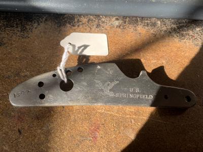

Recently purchased a small lot of gun parts, mostly trapdoor. In the mix was a lock plate marked 1867 and thinner than a Civil War era lock plate. What kind of cobbled up Bannerman nonsense is this I thought to myself. Until I did a bit of research. It appears that I have a lock plate that somehow ended up in the wild from one of the 424 Cadet rifles produced that year.

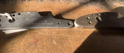

[attachment=1
Re: A blind squirrel finds a nut.. 1867 Cadet
The date does not look to have been stamped by Springfield and it also looks to be placed incorrectly?? The lock plate should also be thicker. Here is a complete 1867 cadet rifle on GB.
https://www.gunbroker.com/item/1016322053
If anybody wants one, that's about as nice as you're likely to find; considerably better than mine.
The lockplate under discussion is a FAKE. It is a .45-70 plate, inscribed by Bubba (man. that guy got around!) The true 1867 plate is of a thickness between the CW and flat styles, but has a bevel similar to the former.

Man you guys are good ! Comparing it to the original in the GB link I can see several things wrong with mine. This is why I come here. Things I noted right away besides the incorrect thickness. The "1" dosn't have a line across the bottom. Numbers aren't perfectly aligned. Eagle is too close to the "Springfield" stamping. I'm sure there's more. The question is why someone would do this ?
nhbandit wrote: Fri Nov 03, 2023 6:28 pm Man you guys are good ! Comparing it to the original in the GB link I can see several things wrong with mine. This is why I come here. Things I noted right away besides the incorrect thickness. The "1" dosn't have a line across the bottom. Numbers aren't perfectly aligned. Eagle is too close to the "Springfield" stamping. I'm sure there's more. The question is why someone would do this ?
Easy answer - they were trying to fake an extremely rare model for sale to some novice. Either that or they had delusions. You have to do a LOT more to fake that model than change the lockplate. Perhaps they got caught . . .
