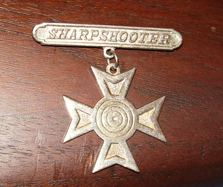

Question for Tom. Do you have any information on that sharpshooter medal in your avatar? I bought its twin at and antique emporium several years ago.

Tony, That is the first sharpshooters cross it was introduced in 1884 and was to be worn at the throat of the uniform and then in 1885 replaced by the well known sterling silver sharpshooter bar with suspended cross. Total production was 1000 produced. Also there was a marksmans bar 2500 produced that was not well received as well some called it a door plate with scroll work on top and bottom. That also replaced with the sterling silver marksman bar. You were lucky to find one mine took some years to obtain.

Tom Trevor wrote: Tue Oct 03, 2023 2:19 am Tony, That is the first sharpshooters cross it was introduced in 1884 and was to be worn at the throat of the uniform and then in 1885 replaced by the well known sterling silver sharpshooter bar with suspended cross. Total production was 2500 pieces. Also there was a marksmans bar that was not well received as well some called it a door plate with scroll work on top and bottom. That also replaced with the sterling silver marksman bar. You were lucky to find one mine took some years to obtain.
Are the 1884 crosses silver? I think I have one somewhere too.
Re: 45/70 case prep
No Dick the 1884 sharpshooter cross and marksman bars were bronze with a cross pin back.
Re: 45/70 case prep
Tom Trevor wrote: Tue Oct 03, 2023 3:59 pm No Dick the 1884 sharpshooter cross and marksman bars were bronze with a cross pin back.
Hmmm - the one I have (somewhere) is silver=colored. I am sure it has a cross-pin back, though. Maybe it is later, or even bogus. Medals have never been my strong point. I THINK it came from S&S, 40+ years ago . . .

Just dug mine out and it looks like the later version with the bar. Not the "good one", but still happy to have found it.

Tony, That style is 1885 and later. If the soldier qualified as sharpshooter for three years not necessarily in a row they got a swallow tail bar that went between the top bar and cross I have one with bar dated 1922-23-24. I am not sure when they were discontinued.
