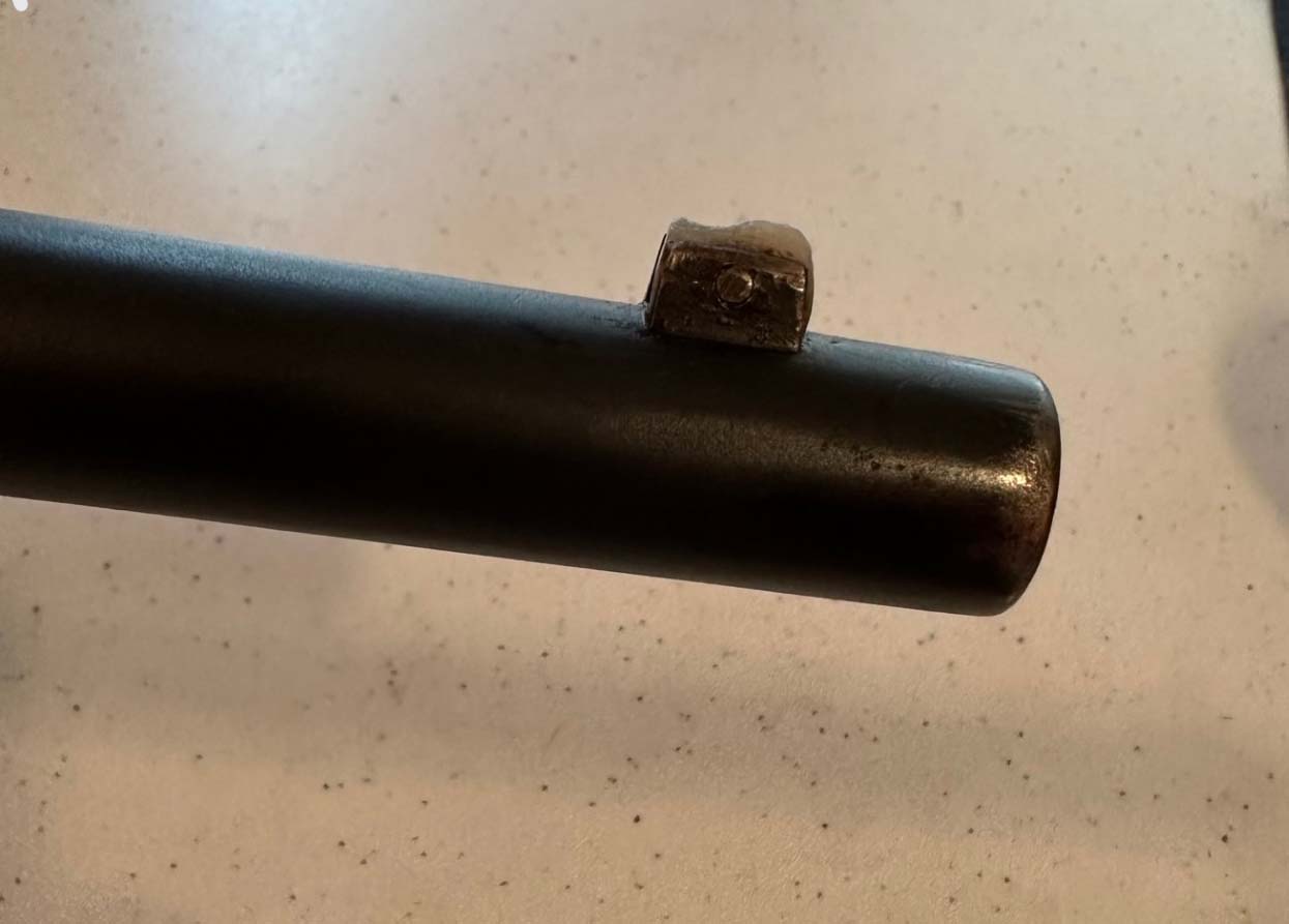

I you wouldn't mind one more question, I wonder if you know what the front sight blade height and thickness was on these 1873 trapdoors with Buffington rear sight? The replacements I've seen offered online vary from a thin, tall blade to a shorter, thicker wedge. I've only had mine out one time at the range when a buddy loaded up some light loads with 350 grn bullets and it was shooting about a foot high at 50 yards. The front sight blade on this rifle was obviously replaced at one time with this piece of white plastic. Any help would be appreciated!
Kroil did the trick. Got it loose and now functions well. Much obliged!
