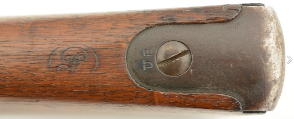

Any idea what this marking is?
New listing on Joe Salter site. Looks pretty standard other than this, and addition of steel pistol grip.

I have seen that mark (or one VERY similar to it) in the normal cartouche position. Wasn't there a brief period when neither Allin nor Porter stamped a few guns?
Also of note, that is a case-colored type 1 block - ODD.
Despite your comment of a week ago, that serial range (60-80k+/-) DOES have some interesting "transitional" variations, when you figure that the following features each only existed for very short period, but with some overlaps: Long-comb stock with narrow inlet, high-arch block without eagle/arrows, narrow low-arch block, gas-escape change, etc.
