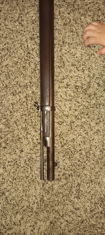

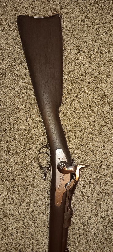

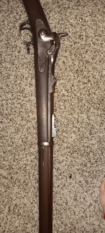

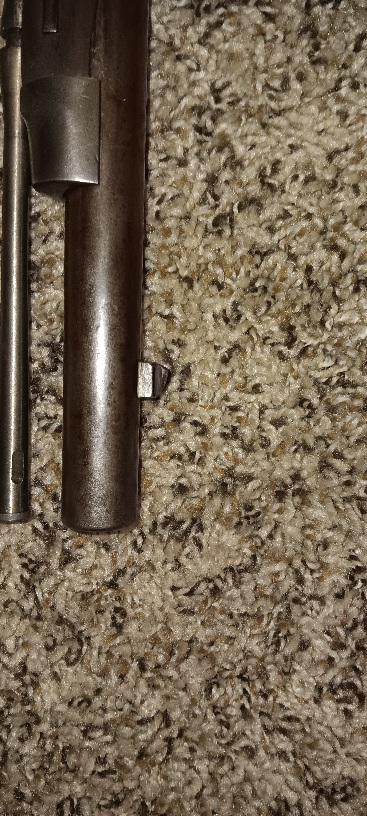

I didn't know the stock was missing - thought it was just "sanded"? Maybe some pics of that? Sort of longer shots though, not extreme close-ups.
Solidleadslug
Posts: 64
Joined: Wed Feb 28, 2024 4:26 pm
Re: First model 1873
Post by Solidleadslug »
No it's stock isn't "missing". Just lightly sanded. I'll post a full picture
Solidleadslug
Posts: 64
I apologize if some seem fuzzy. I've had to resize them significantly to upload to this forum
Solidleadslug
Posts: 64

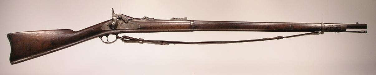

From your pictures, I would say that stock is entirely appropriate to the rest of the gun, and wouldn't do a thing to it. However, the cleaning rod is the later smooth type (POSSIBLY a repro) and the upper band should be the very first type without stacking swivel. Personally, I think the rifle is worth making those changes. Here is 12313:
73 rifle 12313 - right side overall.jpg (27.83 KiB) Viewed 10320 times

Thanks for that picture for comparison. Is it appropriate to saw those missing item could be found on say a 1869 and 70 trapdoor? I have a few of those 50-70s with some spare parts.
Close but no cigar - the barrel diameters are slightly different. As to the rod, the '68 won't work but the 1870 is the same rod as the '73, except for a slightly larger diameter head, and being bright instead of blued. If you have parts to trade, you might be able to get off fairly cheap with the parts houses. Try S&S, Granpas, Lodgewood, etc., or eBay if you have to buy outright. What you need may not be under every bush, but they're not impossibly rare, either.
