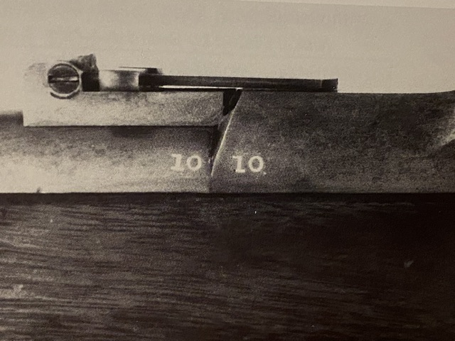

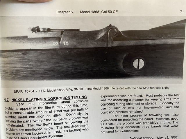

One of the interesting things in Chapter 6 is where you can see the rear sight base on serial number 10 is also sitting within a cut on the receiver.
I wonder when that feature was changed.
Serial number 10 was the first rifle with the flip up long range sight installed on it.
It seems that the prototypes went further than just the first ten rifles.

Uhhh, not so fast. We know about 6 and 10. What about 7, 8, and 9? Maybe 7 had the first long-range sight?
Also of note is the font for the numbering. 10 is different, while 6 uses the same italic stamp as final production? Interesting.
Re: 1868 #6
I was just going by Al’s book.
