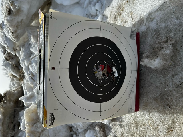

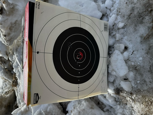

So I made some up. (These loads are only safe in my gun and aren’t tested for safety, so don’t use my loads or techniques ). They are actually pretty darn accurate. I tried a couple loads, some I used a very light load of 3f and it drove the collar button bullet to 650 fps. The mould actually comes with a load data sheet for smokeless. I have found that if I use my normal .460 deep expander I can push the bullet a good ways down into the casing and it seems to be more accurate . Using the standard lee short expander I can crimp them in the end of the case and they load and travel better and are nearly as accurate but fouling is worse. With a clean bore I bet I could do a 2” group at 50 yards rested. This 5 shot group target was done standing at 40 yards.

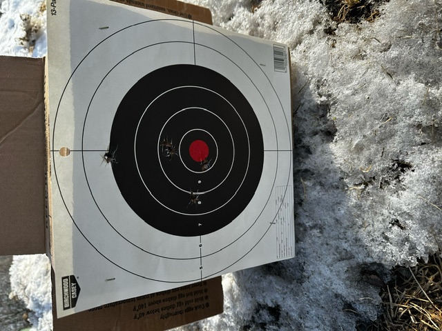

Dang that’s a good deal on the 500gr. Mould. I shot some groups today with my 1882 carbine with the bullets pushed down as far as I could in the case before distorting the bullet and got some really good results. The carbine has a really good bore. The bottom target was offhand at 30 yards 6 or 7rounds and the top was at 40 yards leaning against a car, semi-rested I guess lol it’s 2 different groups of 5 shots I adjusted the elevation for the second group. This time I swabbed the barrel every 5 rounds. I’m testing different powders including BP substitutes that I won’t go into.
