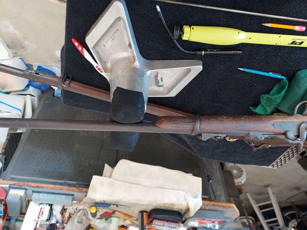

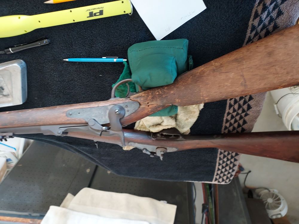

I also received this carbine that looks as it has had a hard life but still neat s/n 143746

The carbine seems to be all correct, except for the obvious problem of the broken stock. It is in a serial number range full of carbines, although there is no documented history on this number. A good woodworker and epoxy can fix that to stabilize it and the repairs should be merely "there" and not "screaming ugly". A bit of linseed oil afterwards will blend in the colors and greatly improve the overall appearance of the stock without any unnecessary sanding or making it look "too new."
